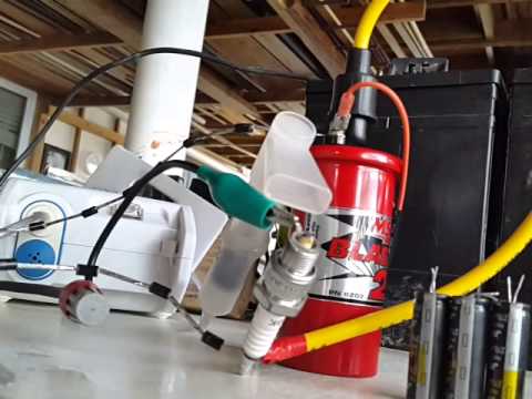

    • http://youtu.be/Tjt67RFgREk
      Here is a video showing nebulized water over a plasma spark plug.
      How do I go from here with the booster caps and diodes?

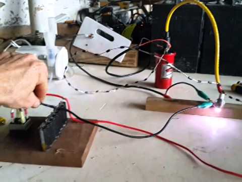

              • This is a video showing boostercaps and the diode string. I am not sure about the direction for the diode string.
                • Diode string direction.
                  If I put all the diodes the same way, would that not lead to a straight path of cap dump into the MDS? I am afraid of frying the MDS.
