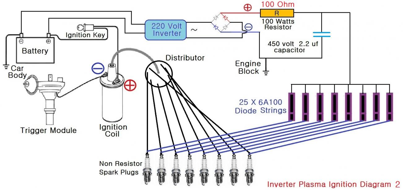

              • To akosiwilly
                Thank you for your reply.
                I upload a new schematic diagram for real apply to vehicle.
Name:	Inverter Plasam Diagram 2.jpg
                (1) Is this right diagram ?
                (2) If right, I think the capacitor will be run out shortly.
                How do your experience in real world ?
                Thank you.
                • your diagram is correct. Even with with my homemade inverter i dont have problem running this circuit. and the capacitor discharges is pretty impressive even with using high uf capacitor at least for 3,000 RMP coz my car has only small engine. If your inverter (since it's the one controlling the frequency to charge the caps) can run at high frequency i think it can handle fast charging at high RMP. i wish you luck. If you can find best quality sparkplug then you can try high uf for long period. By the way, this circuit will interfere with your onboard radio. Is your car having a ECU (electronic controlled unit)?
